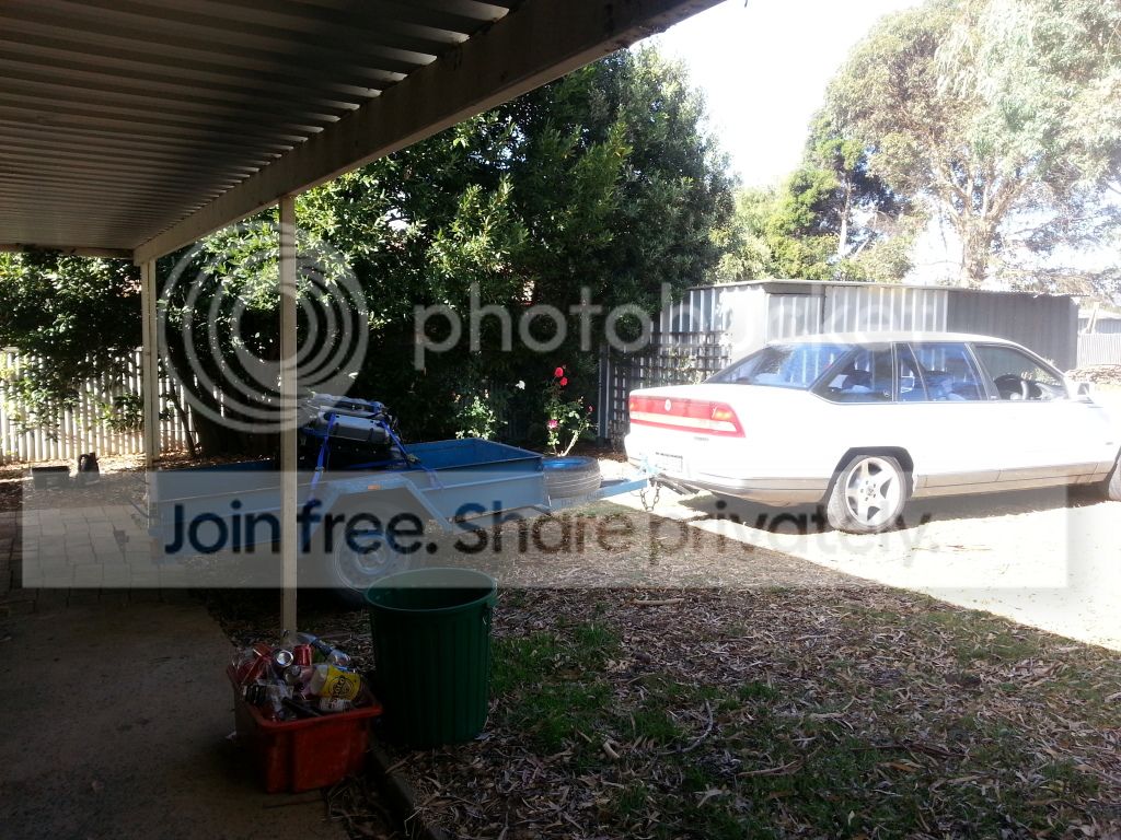

    Picked the new engine up yesterday, now to get started on it. (Now the car's all dirty after it's long drive out bush)
    (Pulled over by a funny cop on the way home who told me I can't have 16 cylinders on a stato haha)

  15. someguy360
    someguy360 Well-Known Member
    2,298
    460
    Jan 29, 2011
    Adelaide Hills
    Engine is back on the trailer, ready for its trip down to Adelaide monday morning to get dropped in the car.....So hopefully by next weekend it will be running perfectly again :p
    Then the real engine build can begin once I get the old block back ;P
