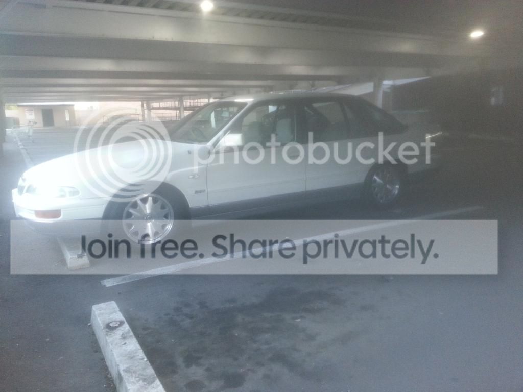

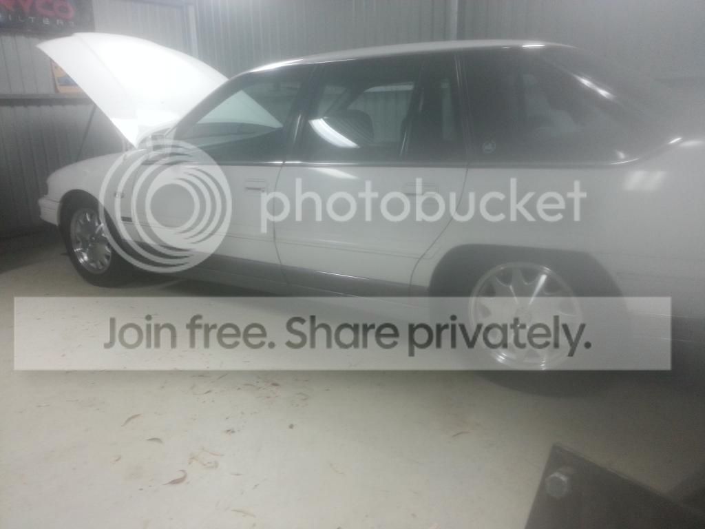

    After searching for a few months finally found a mint set.
    WH Caprice's
    (excuse the ride height, the rear of the car was still on stands at the time).
    Undecided as to whether I will get them polished or leave them as is, the way they are is really easy to keep clean which my polished calais wheels certainly weren't.

    Any full car pics with them on ?
  13. someguy360
    someguy360 Well-Known Member
    2,298
    460
    Jan 29, 2011
    Adelaide Hills
    Not yet, car hasn't left the garage yet.
    Will do it on the weekend.
  14. iChris
    iChris New Member
    369
    Jan 24, 2012
    Perthvegas
    are they series I or II? I think these are from a series 2 WH caprice.
    great to see you went with a classy looking wheel and not gmax heritages or vy sigs like most people get for a statesman. if I was to ever change from my eleanors, I'd be getting some WM caprice wheels modded to fit my wk.

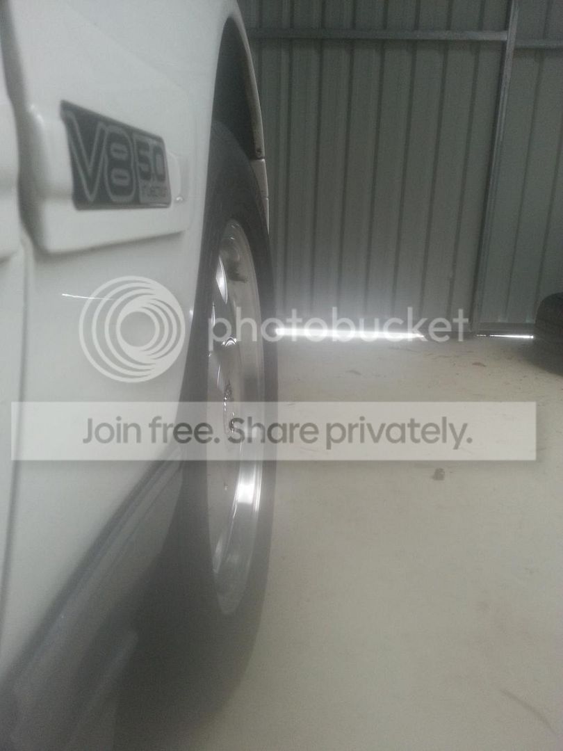

  16. someguy360
    2,298
    460
    Jan 29, 2011
    Adelaide Hills
    Excuse the crap pic (my phone's lens is nackered).
    Love the subtle dish on them.
    Some will like them, some will hate them.
    (Man my car looks high in pics)
    Next visual mod, tint, not too dark just something subtle.

    Which = comfort. Stato = comfort. Height = win.

    Next mod, get a better photo capturing device haha.
    I think the heights perfect mate haha
  19. Wozza
    Wozza Well-Known Member
    1,890
    285
    Dec 13, 2011
    VR_GS commodore
    Looks fine to me ...what tire size are you running? you might be able to fill the guards a bit more by playing with tire profile and width...what happened to your old wheels? :)

    225/55/16 i'm pretty sure, the guards are pretty much filled when looking at the car in person (wouldn't be able to fit your hand in there, it's just in pics it looks so much higher than what it is haha).
