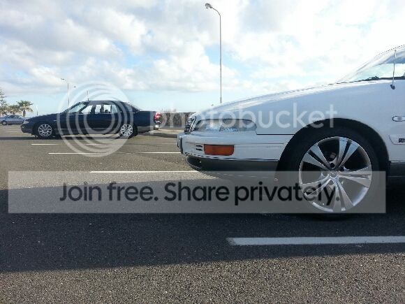

    Well the old girl survived 3500km of daily use the last 3 weeks.
    Promised myself this fortnight none of my wages are going towards the car, the last 7 months I have pumped too much money into the car and not enough into finishing my renovations......although the ebay/repco bug is trying so desperately to get me.
    Friend photoshopped on some white walls, I think they would look good......a little worried about the cop attention in SA at the moment (lot's of defect stations out) so I have decided not to lower it or do the cam until the heat is off......if I get defected it will be a couple of grand to get it passed through inspection.
    Entire car is now nolathaned, loving the handling through the back roads near my place.
    Also invested in a new timing light, I had never checked the timing since the engine was dropped in......it hasn't felt great or sounded very good compared to other 5L's I have driven so I whacked the timing light on it and the workshop had set the base timing to 17 degrees advanced BTDC so the spark was way out.....put it back to 10 degrees then gave it another 2 degrees for 98 fuel and it is like a new car.....I'm assuming the workshop that dropped the motor in just turned the dizzy until the engine fired and never bothered to check it....I am very lucky the motor still runs after running 5 months with that much advance.
  7. Trayner
    Looks good with the whitewalls man , needs to be a tad lower in the rear thou . Just so its a little bit more level
  8. James909
    James909 James
    144
    Jun 22, 2012
    VR Statesman
    Look nice mate. Yeah agree with trayner, about the rear, would look nice when you do it.
    Good to see it survived as daily.

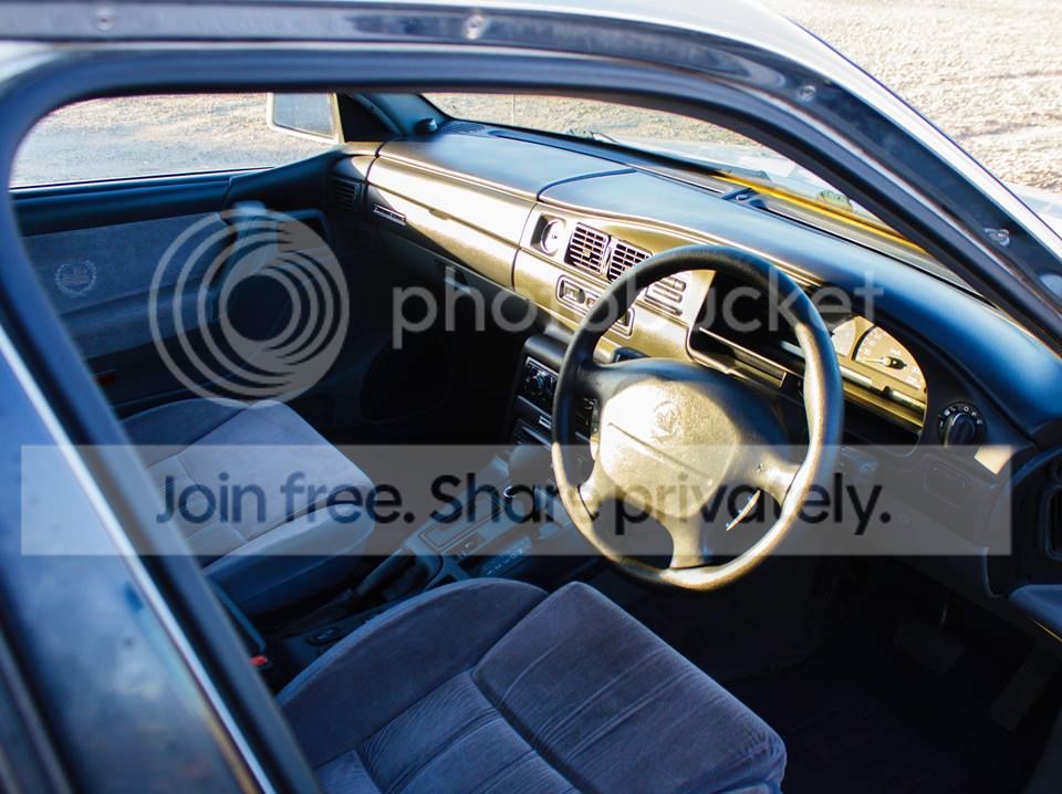

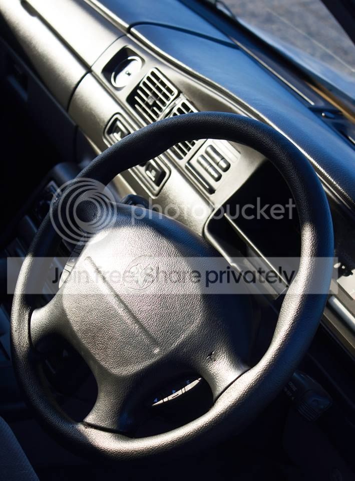

    Got some photos of the interior for a change, it's amazingly clean.....looks like nobody has ever sat in it.....perfectly preserved.......the cleanest example I have ever seen for a car of its age
  15. someguy360
    someguy360 Well-Known Member
    2,298
    460
    Jan 29, 2011
    Adelaide Hills
    Interior pics.....all stock except for the headunit and that's how it will stay

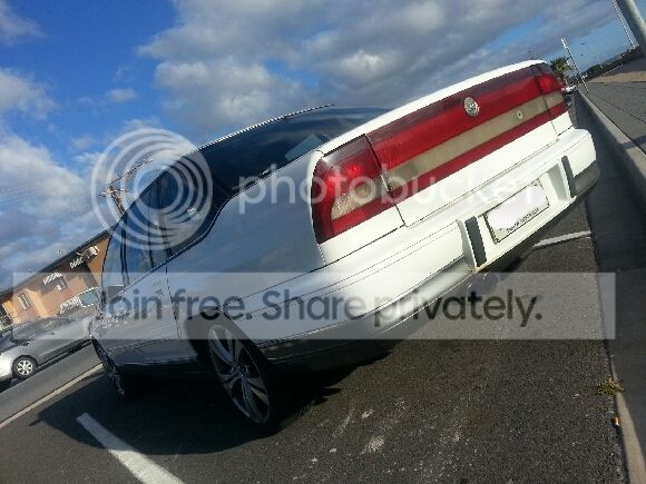

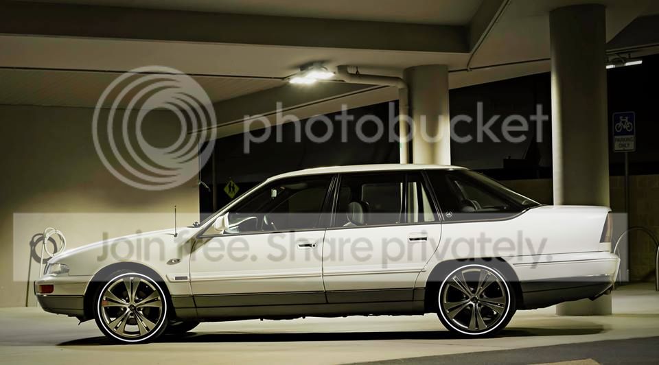

    Updates:
    Ended up getting rid of the 18's.....they were just too boy racer for me, ended up sourcing a set of VS Calais wheels (I wanted either polished VS Calais or VS caprice to give it that classy look) and set about polishing them and cleaning up the surface scratches etc, 19 hours later they are done, not quite happy with the result so when I need new tyres I will strip them off and take them to a commercial metal polisher.
    Sneak pic as the long saga began (will get photos over the weekend)
    Floating car:
    Went for a cruise with <RaBBiT> on the public holiday down to the beach.

  20. Trayner
    The vs calais wheels will look mint when polished , Ive still got my s3 caprice rims lol .
