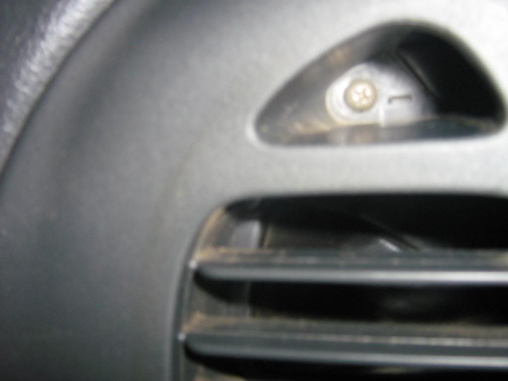

    Hey how do i get the sneaky tweeters out of the dash on my VY commodore ?
    please tell me the dash doesnt have to come out

    Tweeter removal is fairly straight forward. Remove the glove box and drivers under dash panel, now remove the end caps of the dash with the vents that feeds the door. Now there is one little screw that holds down the each windscreen vent. Take it out and lift up. Hey presto.... There is your tweeters.

    But.....to remove the side vents, there are three screws.
    Two of them are are easy to find as you can see the holes.
    But one is sort of hidden at the top of the panel. It's in the very top, small vent outlet and it's a machine thread screw, not a self tapper.
    See the little bugger hiding in there. You little devil.
