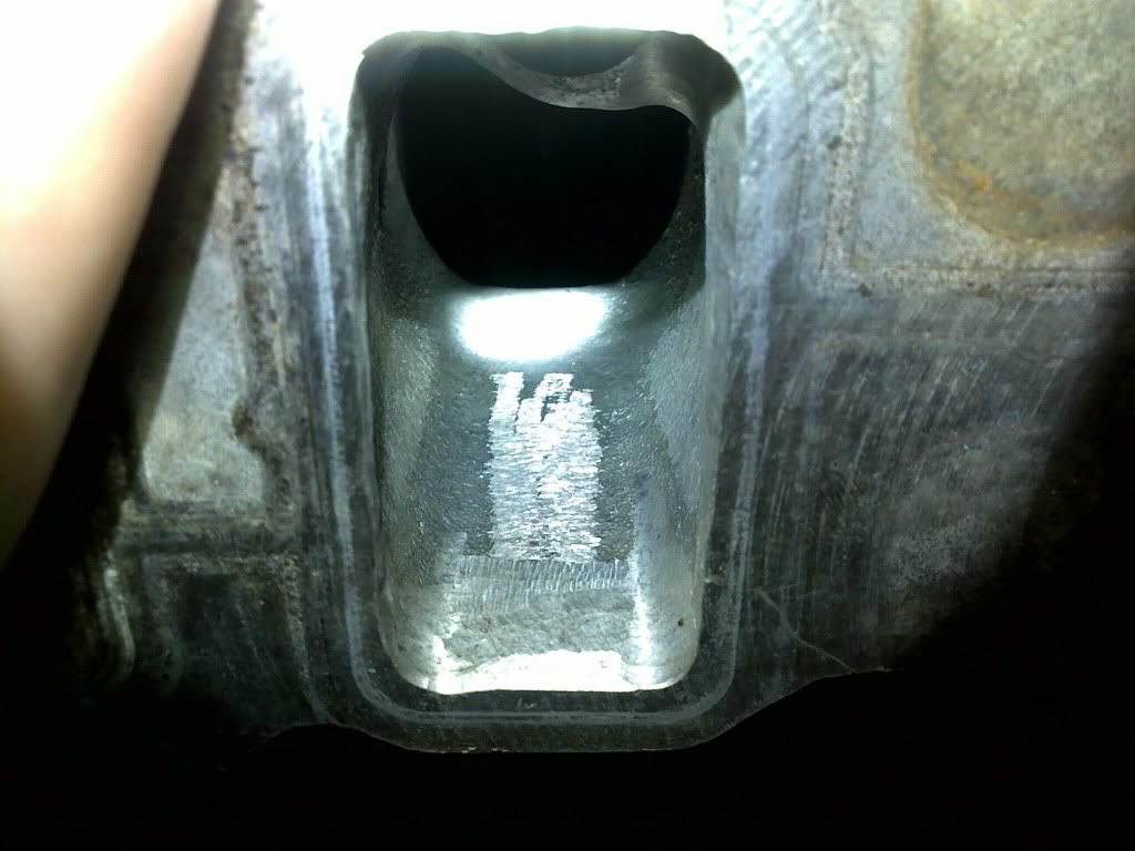

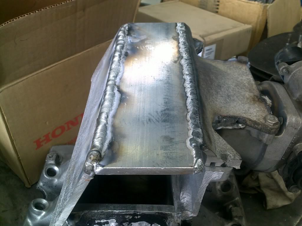

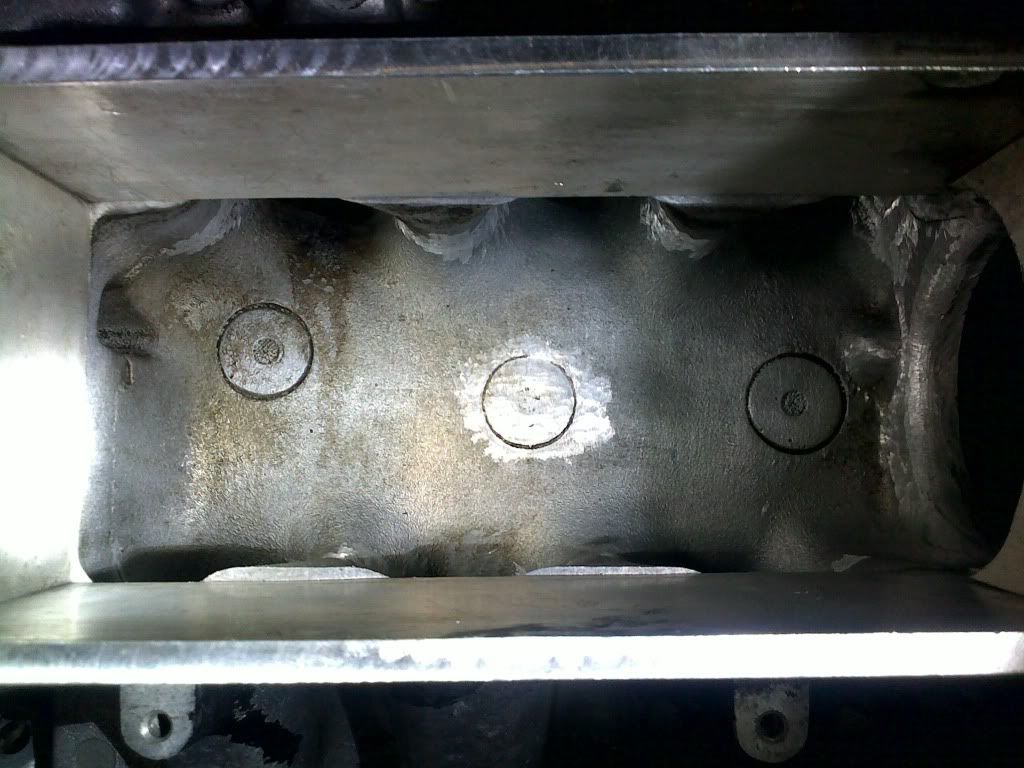

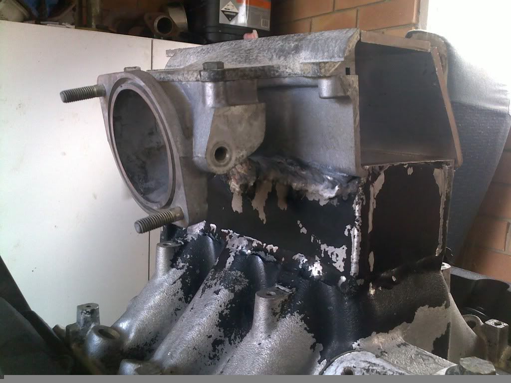

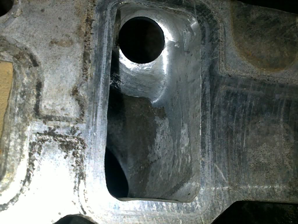

    What have you done with the manifold and plenum?
  2. klampy
    klampy Member
    735
    Sep 25, 2007
    coffs harbour
    Mazda E2000 V6 convert
    manifold was originally cut open so i could gain access inside to smooth the plenum internals (its ported both up the runner and into the head, to the same size as the gasket). it then got a basic square top. iv since broken the engine (snapped cam chain) n it came out n got repaired, so figured when it goes back in its going to get the turbo it was built for. but didnt like the idea of a P/s throttle, so as we know turbos like big plenums. i hacked up an ecotec plenum to be able to use the TB and increase the volume, so it got welded up on top of the old box. so admittedly it probably doesnt need to be so tall but i did it for the internal volume with the aim of trying to eliminate uneven mixtures across the intake runners like the stock mani is plagued with.
    it doesnt actually look like iv done much, but next to a stocker it looks massive.

    its no where near finished of course. but im going to be closing off the opening where the elbow used to attatch, ill be cleaning up the the welds ( was my first n second attempt at TIG. EVER! lol ) and im going to inquire about an extrude hone. but not entirely sure if its worth doing.... depends on what its worth...
