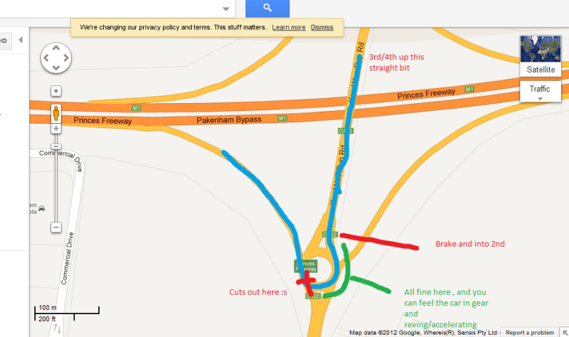

    Ok got a bit of a problem with my t5 in my vs ute
    Look at map below \/\/\/
    Story goes , driving down a straight road about 60-70kpm heading towards a roundabout (the type you go onto to get onto a feeway) so generally 90% time dont have to slow down/stop/shift into 1st .
    the speed limit is around 30-40 at the round about so I go around the round-about in 2nd.
    The car stays in second intill the car gets to the end of the round about then , sorta just goes into Neutral and looses revs . and when you press the accelerator it just revs and does nothing
    So what I do is like shift into N pump the clutch a few times then back into second and it goes fine again ??
    So im thinking im up for a new clutch (Im hoping)
    Also it only happens when I go round this type of round abouts , never anywhere else so its got me stuffed .
    And to make it more weird it only happens 1 out 3 times
    what are peoples thoughts

    Ok took it for a drive just before ,
    Did the cruise at 60 in 3rd then boot it and yeh , it didnt slip but it was a "slow" response to get up and boogie . like normally in any other gear just boot it anytime and it will go so i know its not the car/engine at fault
    and tryed recreating the going round the round about while physically holding 2nd in place and it still did it .
    So now im guessing I need a new clutch lol .
    Anyone recomend a brand or type cheers ? Im pretty sure this one has a Exeddy clutch in it .
    Also what type of cash will i be looking at to get this fixed cheers!

    This is a bit left of field.. but, have you taken much notice of how much fuel is in the tank when you turn said corner?
    when i first got my p's way back my VP would cut out momentarilly (feels like its lost power for a sec) on hard cornering, only right. turns out it was a combo of cracked return line and corroded swirl pot in the tank.
  8. Trayner
    It felt like you put your foot down and it was slowly building up speed then a few seconds in would go a bit more faster , not like a foot down and instant response and off like a rocket feeling .
    Anyways went and tryed your trick , got about $30 of 98 fuel and was sitting just under 1/2 tank full . and it no longer did the cutting out in 2nd around a round about turning right . and it was faster to respond to the foot down in 60 test , So now im more leaning towards the fuel tank problem :(. Anyone know how to/ how much it would cost to get a new swirl pot/return line fitted in ?
