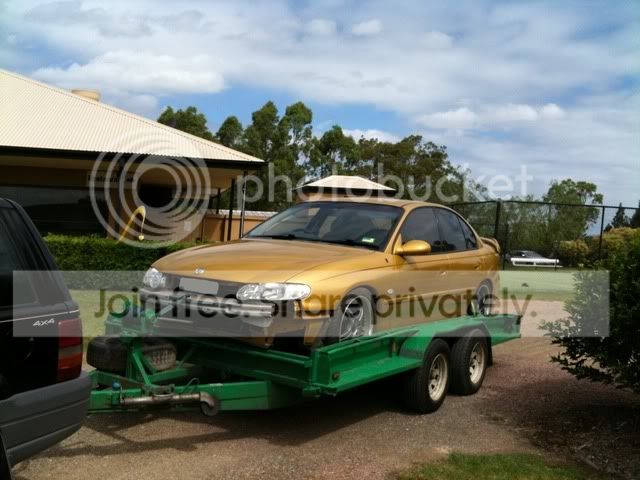

    I started to save for a new heart for the Taxi and a month or so later my cousin in law was back with a car trailer to take the Taxi to his dad's workshop in Lithgow to begin her heart transplant.
    We got the lowest trailer we could but unfortunately the front got stuck on the ramps...... we decided to remove the front bar to get it on the trailer:
    unfortunately this was still not enough (I love how low the car is but not being able to tow it????) so we drove the tow car up over the hill in the background of the above pictures which dropped the rear of the trailer pretty much onto the ground..... WE managed after a few attempts to get the car onto the trailer:
    As the car sat so low on the trailer we had to climb in and out through the window (dukes of hazzard style) so we left it open enough to reach in and wind down the window..... thankfully there was minimal rain......

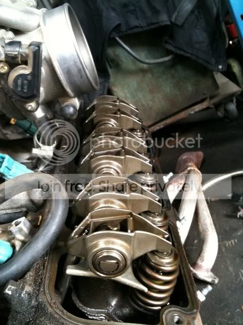

    We dicovered one of the lifters had tried to escape from my old engine:
    I was surprised how good the condition of the rockers and covers were (pics before I cleaned them):
    I decided to use the VX rocker gear on the new VS engine, no real reason as the VS ones were fine but VX ones were in pretty good nick (and looked better with less carbon build up).

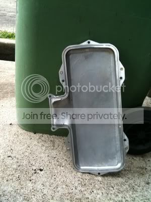

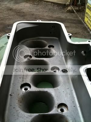

    Whilst the plenum was off the engine I stripped it down and gave it a good clean with petrol and a (fairrly soft) wire brush, I also cleaned down into the runners and any residual gasket off the faces with a razor blade (being careful not to create any pits). When I was done I gave it a hit with degreaser and a gurney:
    It came up pretty good although It had far less carbon than the VS one.

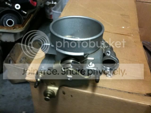

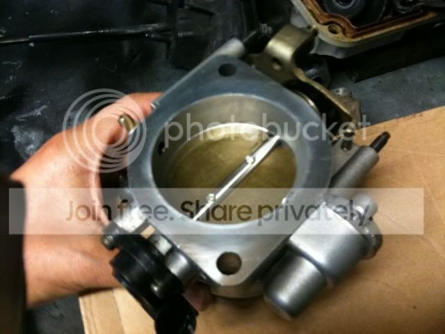

    I also cleaned the throttle body up again with petrol but this time with a soft brush so as not to create any pits. I also removed the sensor so as not to damage it.
    Before (of the VS one):
    After (Of the VX one):

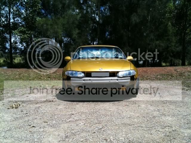

    Would love to drop her a bit more to tuck the wheels a little more, TBH with springs its hard enough getting in and out of the driveway as is lol.....

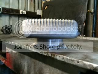

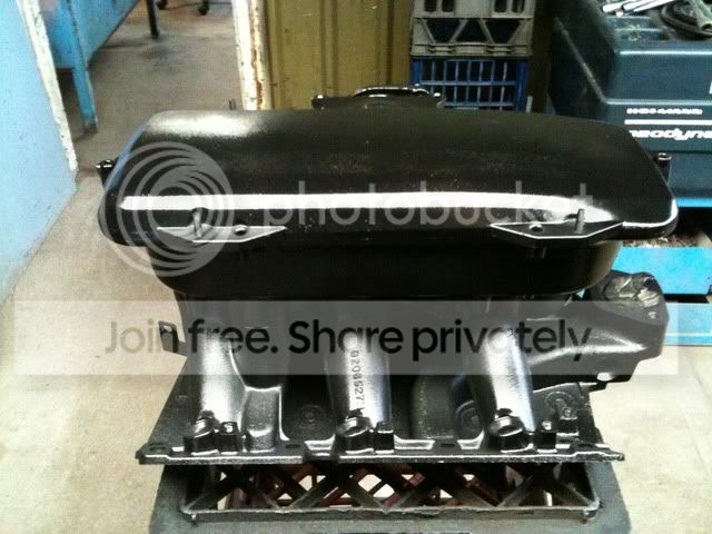

    Thanks :D I decided to go a bit of a different direction with the plenum. I had a look around JC and had seen a few really good write ups on polishing, I had a chat to my cousin in law and he said "Well why don't you paint it black, everything you wear or own is black anyway" so down to the local parts store for a few cans of VHT. We decided to do a matt black and low gloss silver theme on the engine.
    We hit the plenum and runners with some prepsol then my cousin in law hit the whole unit with a few coats of high temp VHT.
    After the first coat for the plenum & runners (whilst wet):

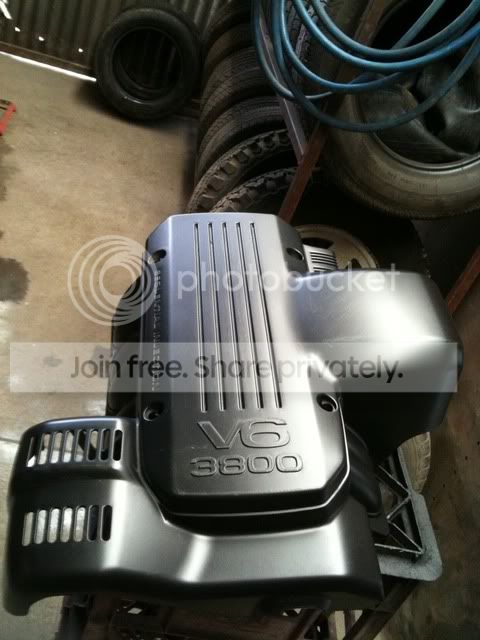

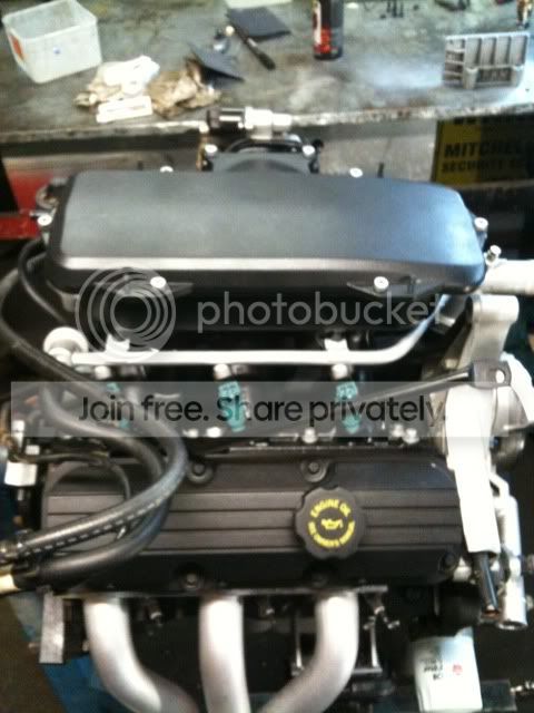

    I had seen the buick style rocker covers but was pretty light in the wallet so we decided just to paint the rocker covers matt black as well:
    We also decided to do the engine cover, just in case I wanted to use it again:
    We also gave the HM headers a quick hit of high temp silver to freshen them up a bit:

  12. GEN3RATD
    GEN3RATD 100% Teflon
    1,580
    Nov 28, 2010
    Cannington, WA
    VE Maloo
    i had the same trouble, so i bagged mine, havent looked back
  13. Low_VX_Taxi
    Low_VX_Taxi Blanned
    240
    Dec 14, 2006
    On the couch
    Blundstone boots
    Bags would be good, unfortunately my boot is a little full with the 15" sub and gas tank lol. I plan to look into different setups when finances improve see if I can maybe squeeze in two smaller tanks etc.
    I love your cars stance (had a quick peek at your thread) :D

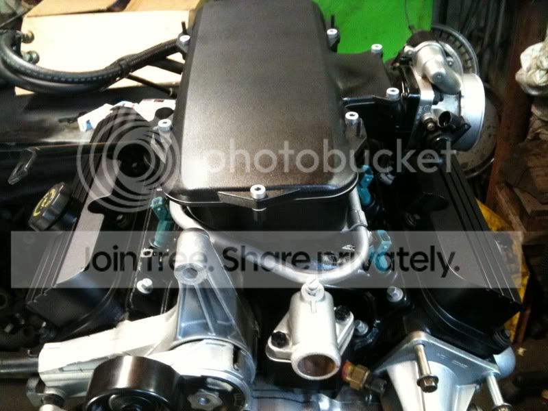

    So the engine started to take shape again so grabbed some happy snaps:

  18. Ed
    Ed New Member
    225
    Aug 26, 2009
    Melbourne, Victoria
    TDV8 Landcruiser
    good write up mate, enjoyed reading it and the pics!
  19. TrikkBen
    TrikkBen I'm Back :D
    999
    Apr 2, 2009
    SE, Vic
    BNR32
    That is the nicest looking Ecotec I have seen. Black is always awesome looking.

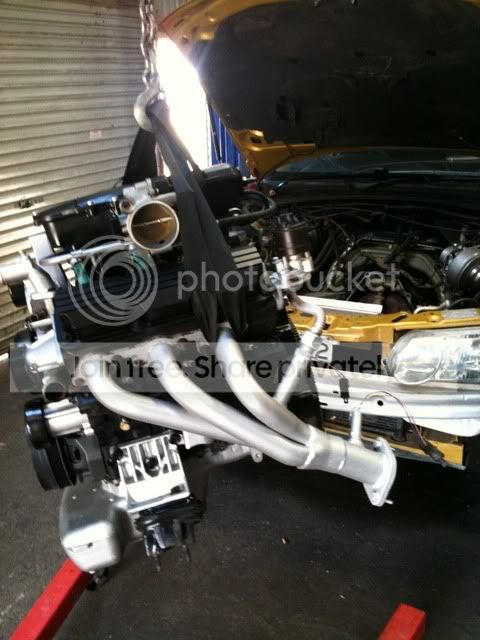

    Took a bit of jiggling but the ecotec was in its new home.
    Next my cousin in law started bolting back up all the ancillaries, put a nice new serpentine belt in and finished assembling the engine.
