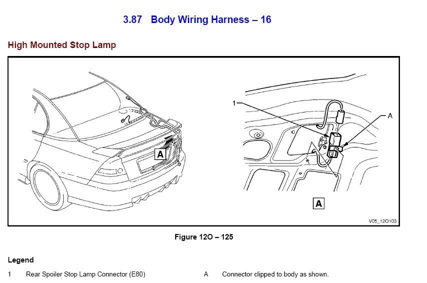

  4. IPCOlsenVZ
    IPCOlsenVZ Member
    103
    May 9, 2007
    05 VZ Commodore Equipe

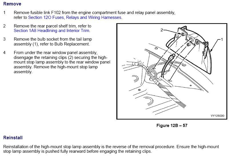

  5. winired
    winired New Member
    Jan 26, 2008
    vz Executive
    cheers for the diagrams.but am trying to clean the inside maybe this picture will help:bow:

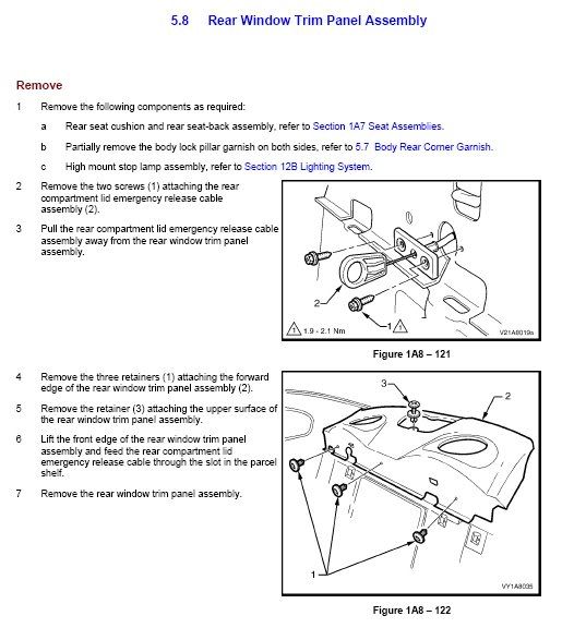

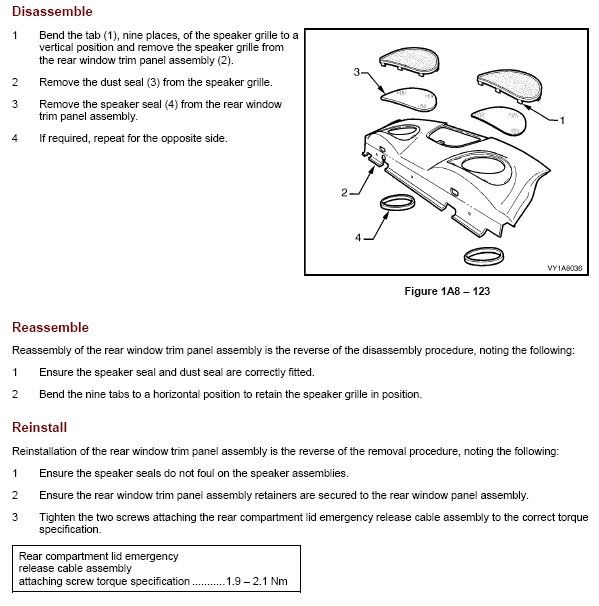

  6. IPCOlsenVZ
    IPCOlsenVZ Member
    103
    May 9, 2007
  7. winired
    winired New Member
    Jan 26, 2008
    vz Executive
    awesome ta IPCOlsenVZ exactly what i needed to know
