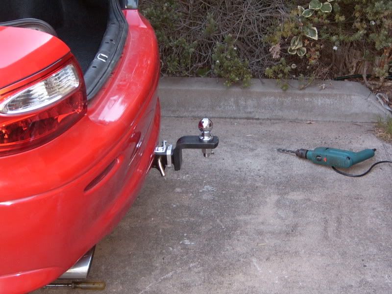

    Have fitted well over a million of the hayman Reese style towbars and other makes or towbars to a VT/VX really easy to do i have some pics below of when i did mine...
    Mine is 1600KG mini hitch bar H/R style the hitch section is 40x40mm. The heavy duty one is 50 x50mm(2100kgs) and has braces that goes inside the boot well it requires more holes bout a extra 8 more holes than my one below.... (take care if you drill the holes on the D/S use a drill stop otherwise you will drill into the fuel tank)
    There is also a standard to bar which is rated 1250kg and has a bolt on neck...
    On the VT the you dont need to cut the bumper bar if you use a hayman reese one P/N 1571 as it comes under the bumper bar if you go for the 40x40mm (P/N RL1810) or 50x50mm(R1803)bar you will have to cut the bumper but there is a dotted outline you can use to do this so its not so bad and the H/R kit comes with a section of pinch mould to go around your cut so it looks nice, Also there is a groumet in the middle of the beaver panel below the boot catch that you can use for the wiring
    WHAT IT LOOKS LIKE WITHOUT BUMPER ON
    HOW TO GET BUMPER OFF
    WITH BUMPER ON
    If ya need any help just shout..... Dont want to brag but use to be able to fit these in 18min flat drive in drive out :yeah::yeah::yeah:
