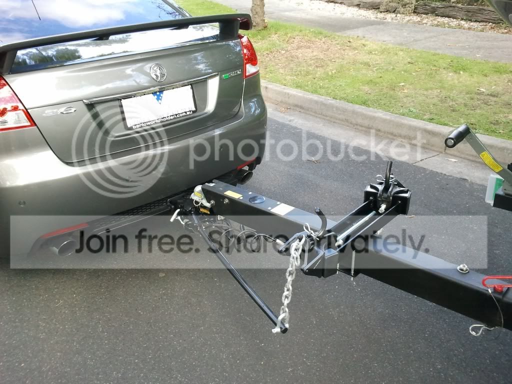

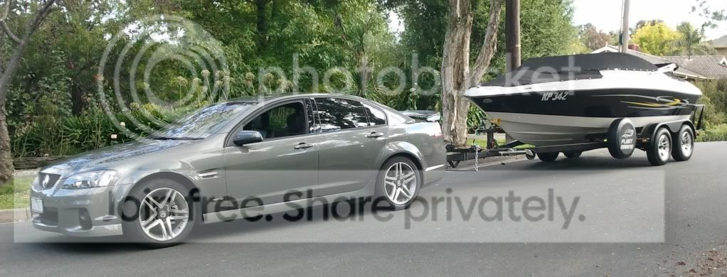

    Don't change your springs - that's just BS and will potentially void your warranty. Use the load levellers GM supply - they work great. I also have a boat - 6 metre - with the single pole leading up to the coupling. I had to make up a bracket to attach the load leveller ends. I believe you may also be able to buy one like this from Haymann Reece...
    Checkout my car/boat combo - http://i670.photobucket.com/albums/vv65/alecowen/2011-04-24152154.jpg
    And this is how the load levellers hook up - http://i670.photobucket.com/albums/vv65/alecowen/2011-04-24152222.jpg

    Thanks Eraserhead, that looks perfect to me. Does your trailer have mechanical brakes and does the hitch affect these?(Just heard it can affect their operation)
  16. EraserHead
    EraserHead New Member
    Apr 16, 2011
    VE II SV6 - Alto Grey
    Barraboy - if the load levelling hitch is set up correctly the override brakes work perfectly although my trailer has 4 wheel discs! You have to set the load levellers up so that when the coupling is compressed (i.e. brakes fully on) the chains should be vertical. This way they don't go 'overcentre' which may affect braking.

    Great, I'll just follow your advice. Now I have to find that bracket but I'll give hayman reece a call first.

    Got the Answer
    Went into ARB in Kilsythe(melbourne) today. They rang Haymen Reece who confirmed the adapter(similar to picture posted by Eraserhead) is available. Its called a "Boat trailer Adapter" for load distribution hitch.
    Should arrive next week and I'll post the part number when I get it. So if anyone else needs one go to your nearest ARB centre and they will get it in for you. By the way its $168.
