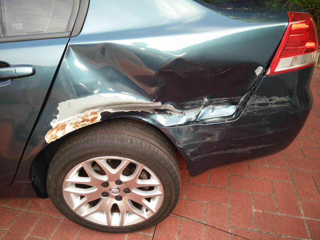

    I may have missed it but how did the rear quarter panel turn out?
  2. VFSV6FORME
    VFSV6FORME Well-Known Member
    1,698
    339
    Mar 9, 2016
    WN Caprice V 6.0L, VE Anniversity V6 Series 1

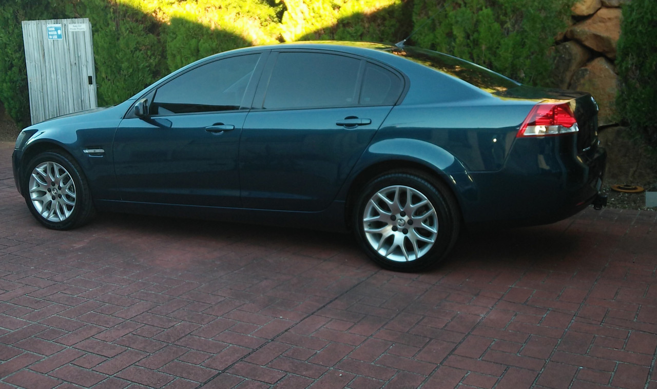

    absolutely perfect! will find put a pic on it
    First I had.
    Then we have
    Mike and Edd from Wheeler Dealers would be proud of me for resurrection this VE. Dont know what that white DOT is but it not there
