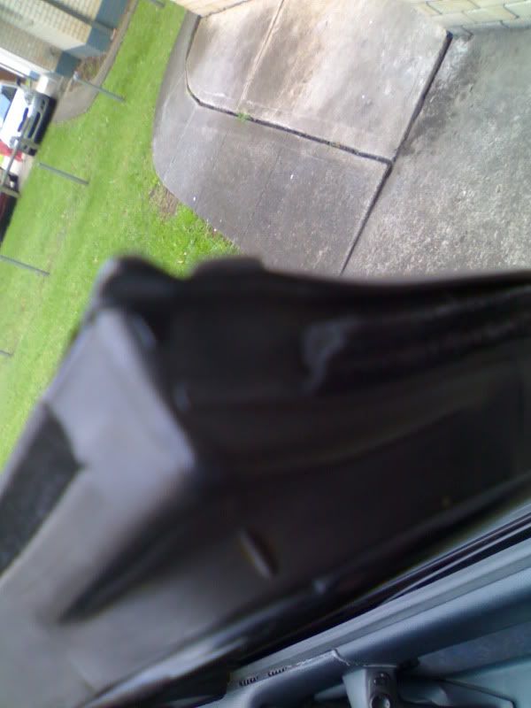

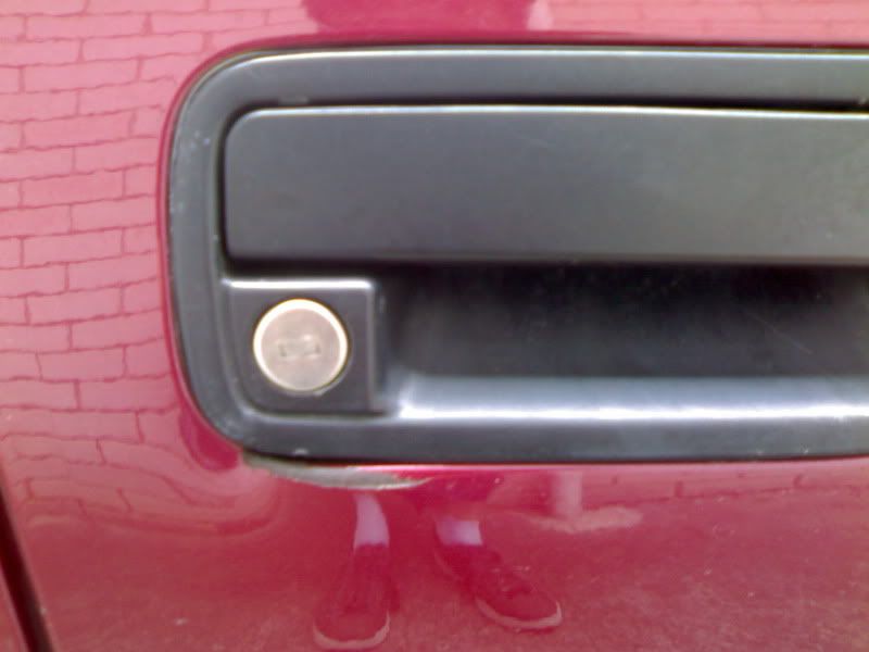

    I think someone may have broken into my car, nothing was missing and the drivers door was still deadlocked but the three passenger doors were open.
    Question, could there have been some sort of malfunction where I have deadlocked the car but not noticed that only the drivers door locked or did someone force entry to the car but the drivers door did not unlock?
    Attached two pictures;
    First is some old damage to the drivers door where I assume the previous owners have had problems, could they be using this as point of entry?
    Second photo is some recent damage (but not from this day) where I believe someone may have attempted entry via the top of the door.

    In the first pic you can see a dent made from the inside, i would be picking they useed (i dont know what it called) a spiecal hammer to try break the lock and get in.
    My mates mums car had a dent like that and the panel beater told her thats what it was.
