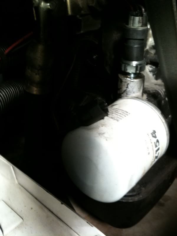

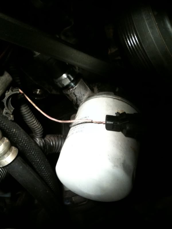

    here are a couple of photos of a wire that was hanging near the oil switch, does anyone have any other ideas, this is starting to get frustrating...

    thats you knock sensor wire its behind the oil filter a little
