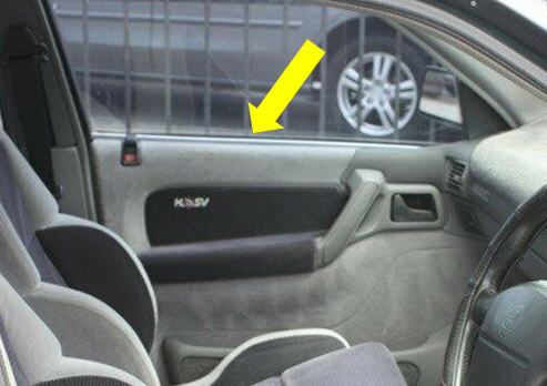

    You still after these? One just came up on eBay on one of my automatic notifications

    Really, no I got one kindly donated off another member, but maybe I will check it out if it's NOS? Cheers

    Well, didn't buy the door strip, but did find a nos rear side back window with rubber, mine are pretty ordinary. Will keep my eye out and see if I can get the other side at some stage, then swap them over :)
