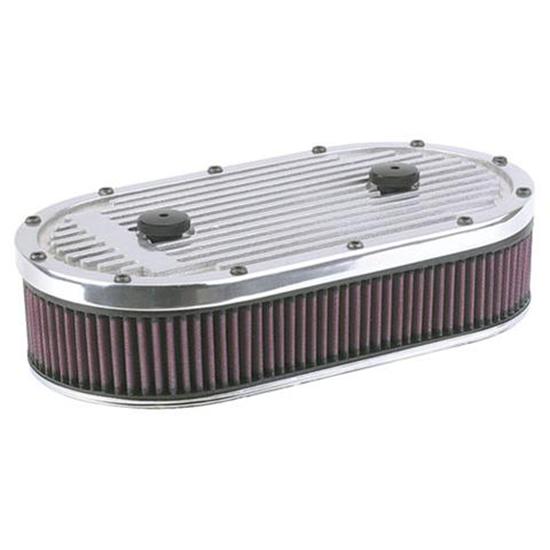

    something like this each side on same angle as the trumpets with the trumpets inside might look coolish

    Thanks, very interesting, be nice if I could get a pair, long enough for one each side. Might do some searching unless anyone knows of one?

    google images oval air filter heaps of styles even 1 filter per 2 TB's so you have 4 mini ovals

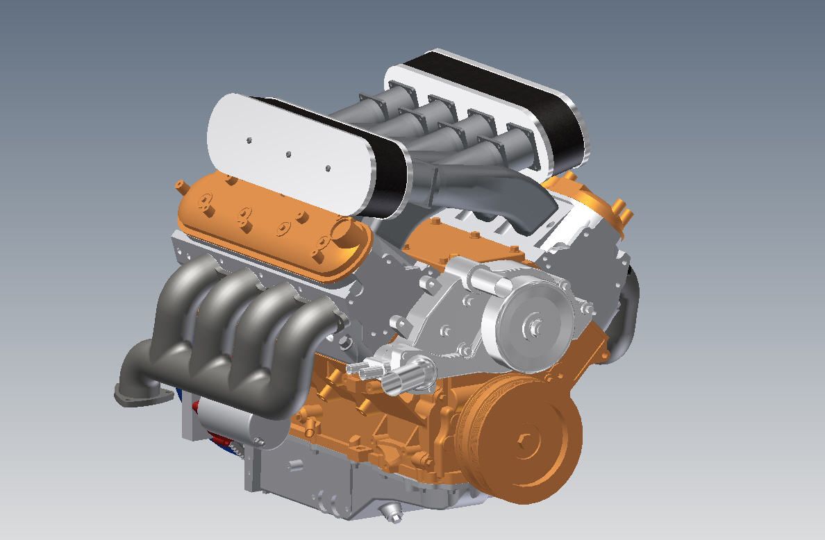

    Had a play with Inventor, maybe something along these lines, have emailed K&N to see what they have or can do.
  19. immortality
    15,023
    3,068
    Apr 15, 2006
    Sth Auck, NZ
    I don't think it would be to much trouble for K&N to make a filter element, you might need to make your own billet base and cover. Fairly simply for a man of your talents.

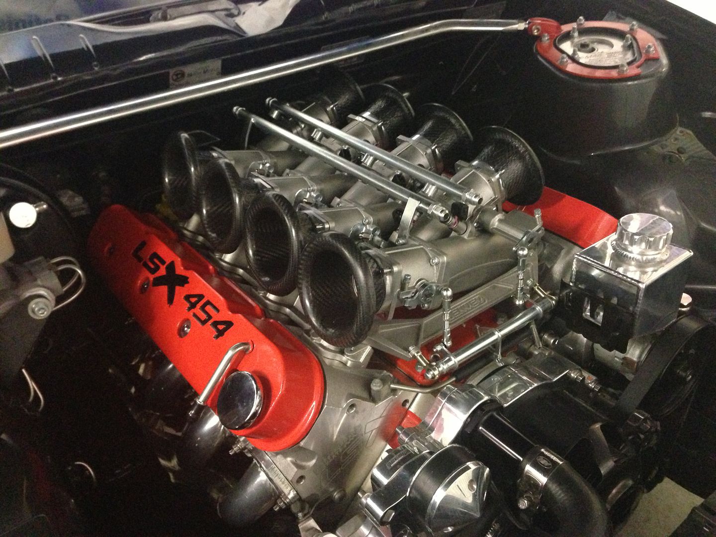

    Had a few people ask when the Street Commodore article is coming out. looks like I made this issue just out. I haven't seen the full article myself yet, but these are a couple of the pics they have put up on their forum :)
