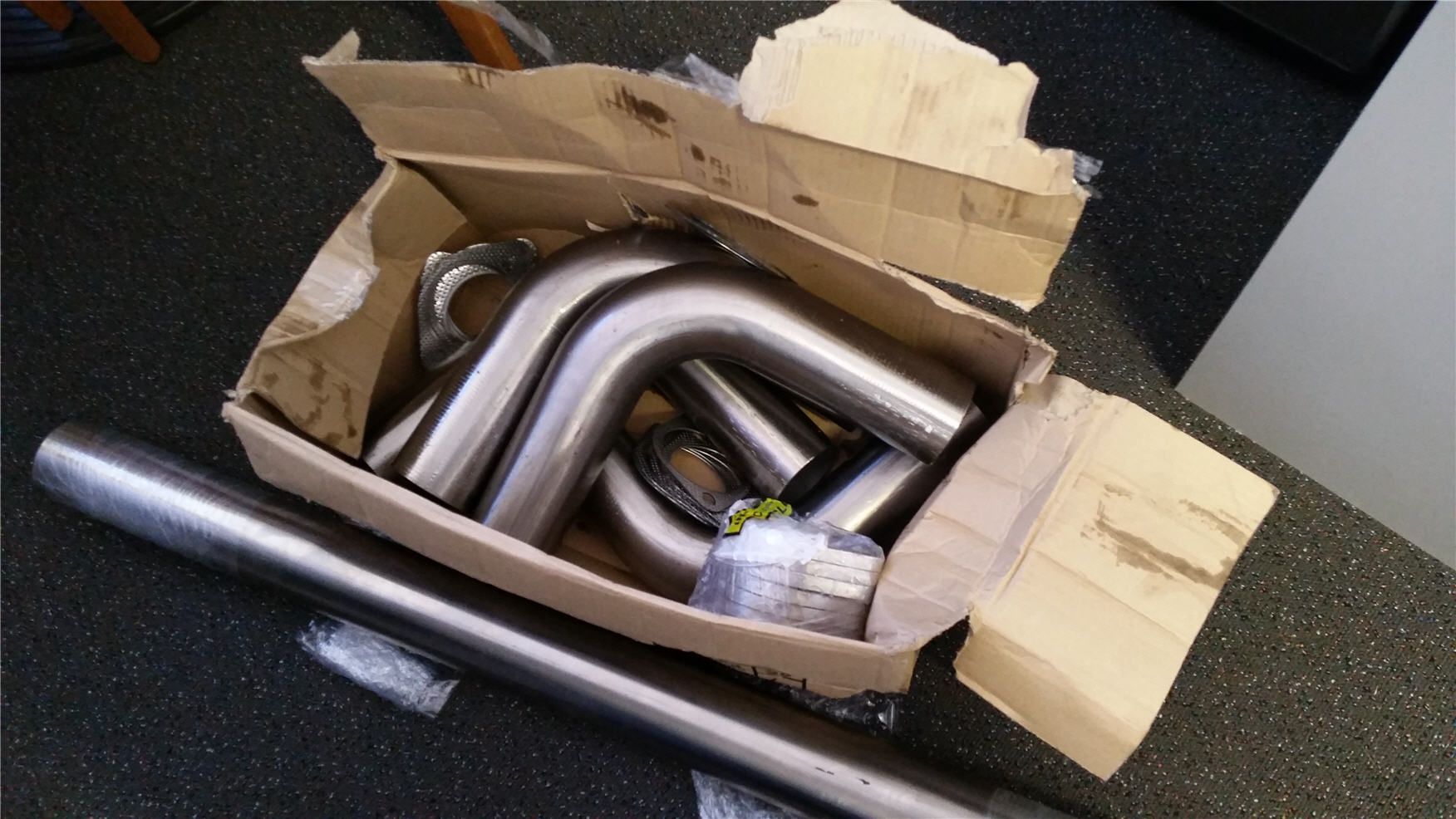

    So have ordered all the pipes and bends etc, so hopefully maybe another night this week, or at least on the week end will get some more done, probably going to take a couple of week ends thought to get it perfect, but reckon I have a plan.

    VR Senator LSx454
    This arrived today, mint, looks perfect.

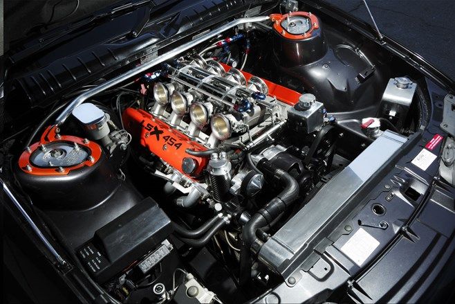

    Yea mate, actually just got it, really happy with it. Love the way he has used the light, finally a pic of the bay that I think looks more like real life
