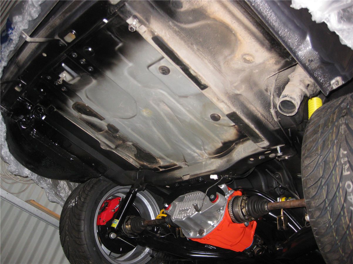

    Good solid day today just doing lots of the little bits and pieces. Did decide to pull the fuel tank in prep for the new tank. Went to paint it with under-body texture coat and the bloody full spray can is seized up bugger it, might try and pop down quickly tomorrow morning before I head to a bbq to do it. I know it wont be seen but I would rather it was all done neatly before I put the new tank back. The new tank should be here in 3 or 4 weeks. Here a gumby before pic for posterity. I am hoping to get some progress pics as the tanks fabricated, if i do i will post them.

    Well finished off using the texture coat around the fuel tank, looks nice and neat ready for the tank. They have all the pump/filters etc so they are about to start manufacturing it, should be sweet.
    This is how the rear came up.
