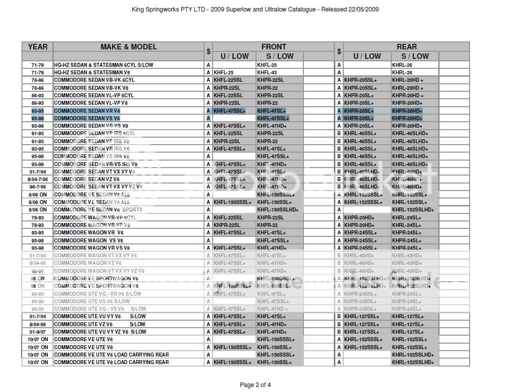

Hey, i'm looking to buy super lows all round for my vs v6 live axel, anyway i was looking in the online catalogue and i found this:
Anyway, notice how the VR ultralow fronts are KHFL-47SSL+, and the VS SUPERlow fronts are KHFL-47SSL+, i thought they would use the same springs, does this have anything to do with the Buick engine weighting less in the VR and the ECOTEC weighting more in the VS?
Either way i want super lows all round (and going for the KHFL-47SSL+ sounds like what kingsprings would reccomend to me) but should i look for KHFL-47SL+ or KHFL-47SSL+ for the front, the back is easy KHPR-20HD for not only the VS and VR but for heaps of others.

From memory the spring seats(on the shocks) are a different height,therefore need a different part number between the two
SSL on the VR will give you next to no shock travel

okay so if on my vs v6 live axel if i got either they would look exactally the same and do exactally the same job, if they are a little different will the SL sit more level with the KHPR-20HD read springs or will the SSL

yea, i got KHPR-20SL on my vr rear live axle . its sit ok (sit nearly to tyre). its not ultralow .. this ads is full of bull!.. u might need grab KHPR-20SSL... will be more low than superlow... i guess

ok well i want superlows and for it, suppose i should go with what the ad says, which by the way is from the kingsprings website so i doubt its full of bull i might contact them just to be certian because im sure the two springs dont do the exact same thing otherwise they would just make them the same name
