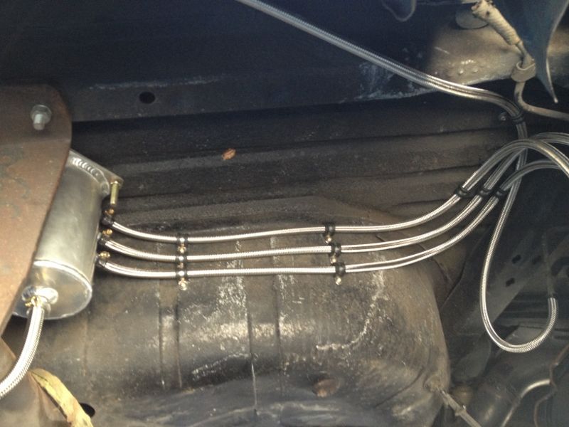

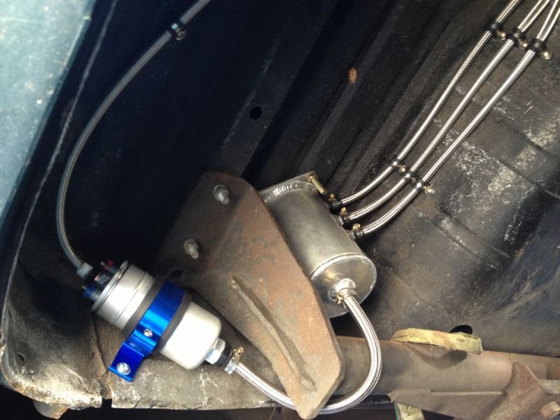

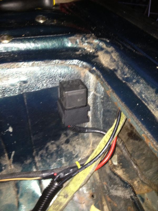

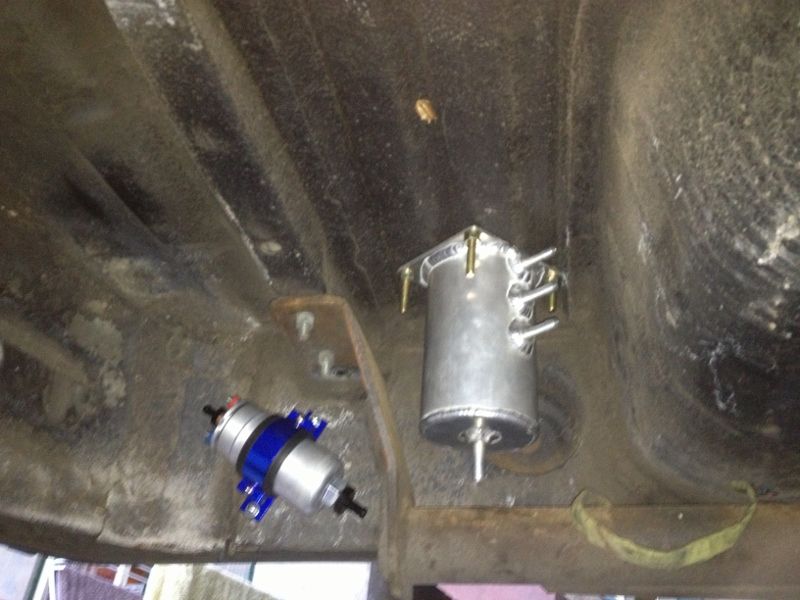

    Got to work installing the new fuel system today
    Surge tank and pump mounted:
    braided lines made up and fitted:
    And where i mounted the relay which triggers off the stock pump:
  5. Jecs
    1,137
    '97 Caprice 355ci & VZ SS Ute
    loving all the pics. keep em coming!
    good job with the fuel system. looks tops

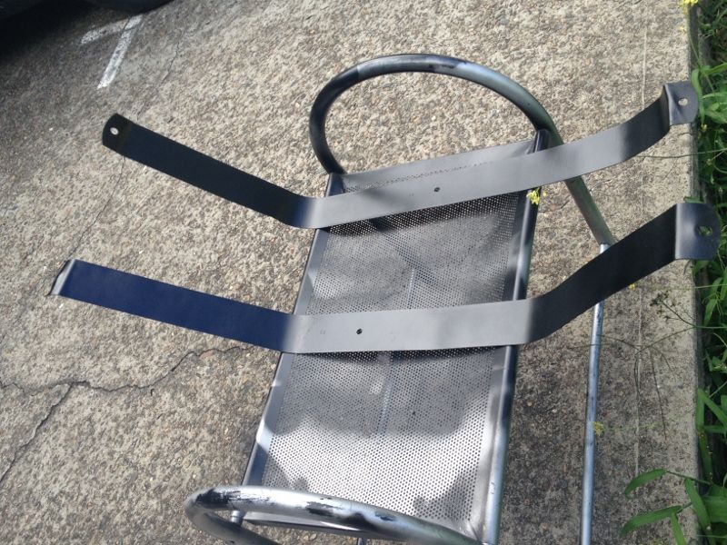

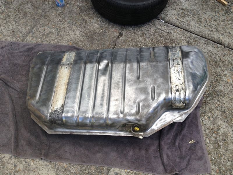

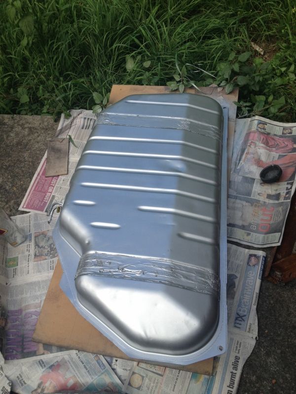

    Thanks Jec's, nearly ready to fire it up again, got the tank and straps painted whilst they were out anyway.
    Gave them a good clean with wire brush attachment, then went silver on the tank and satin black for straps.
    Cheers.

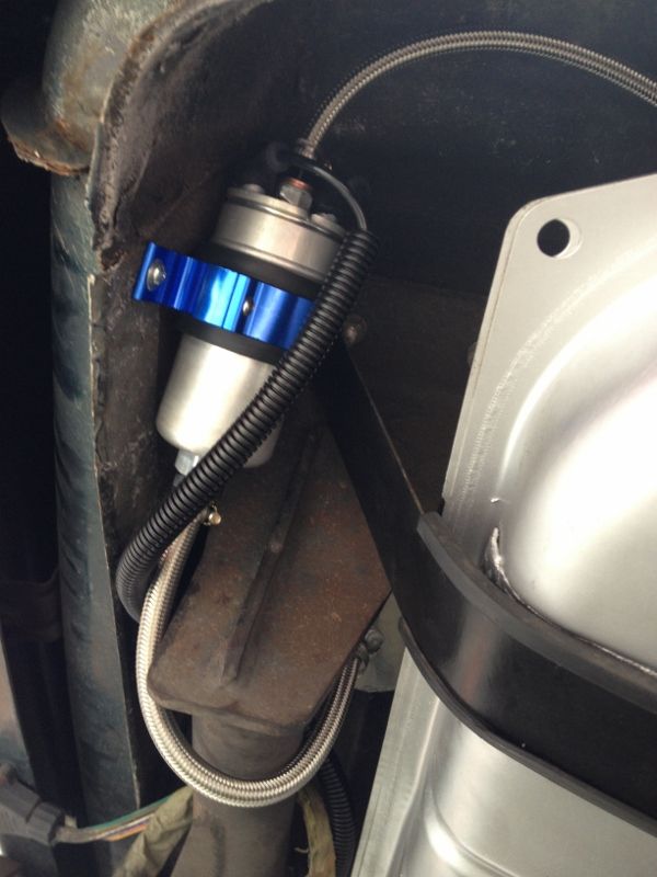

    Got tank back in, replaced breather hoses whilst it was out aswell, Holden dont make em anymore so had to get some equivelant fuel hose from shops.
    Must say these pumps are quite noisy! seem to run a fair bit better too, still way too rich on the afr's so tune should see some good gains.
    surge tank is a snug fit under there

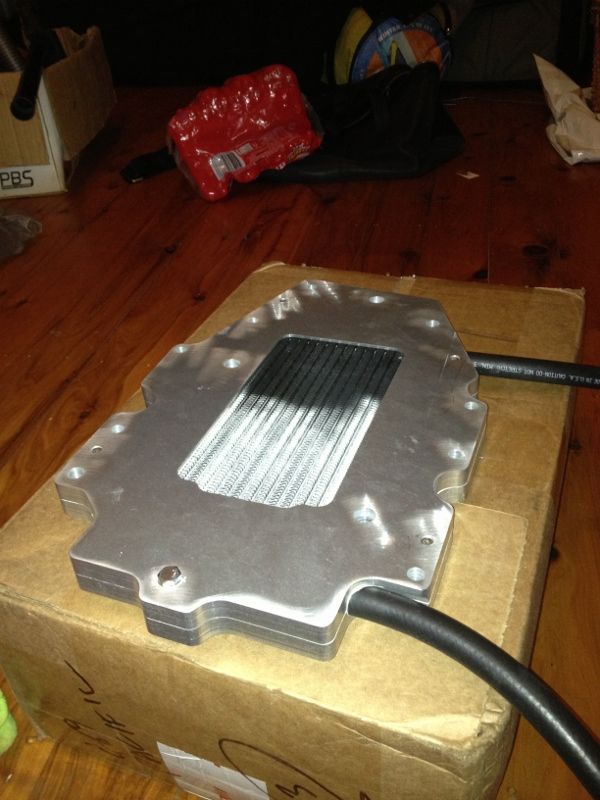

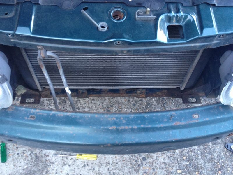

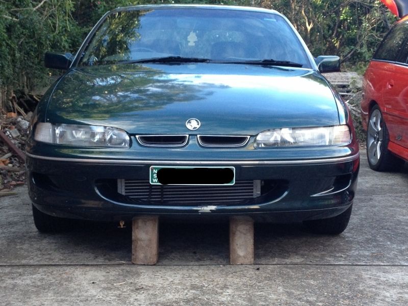

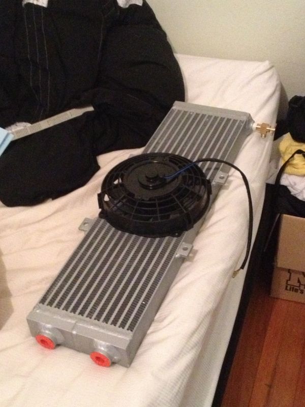

    Intercooler install happening soon, got most of the parts sorted, just waiting on some fittings and fabricating some new fuel rails as didnt want to use injector spacers. Going just a mini core for clearance purposes.
    The cooler plate
    Heat exchanger and Fan i may use
    A/C removed today
    Plenty of room for the heat exchanger + Power steering cooler possibly

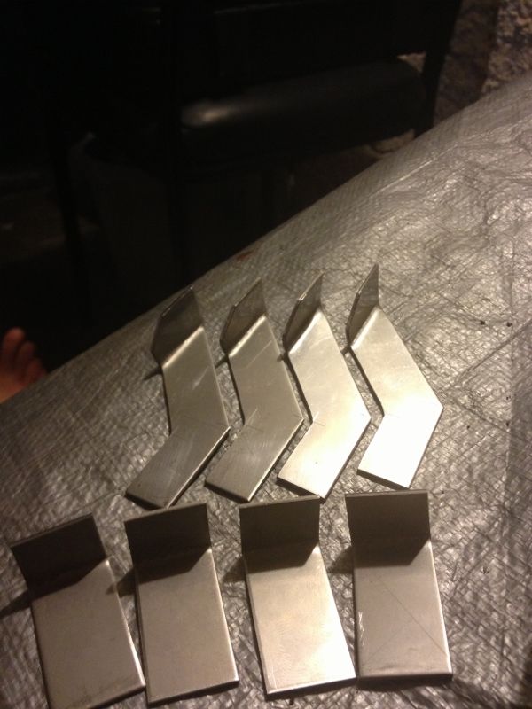

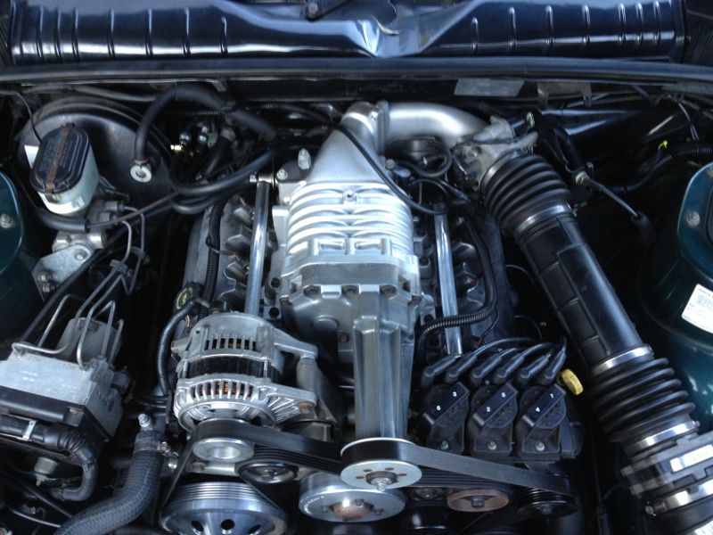

    Some recent progressions, I have been working hard to develop some new fuel rails , Using VS Ecotec fuel rails, which have been highly modified to suit so its now ready for the intercooler install :). I have done a test fit of the FTC intake which needed some slight mods to get it to fit the way i like but its close now, I think the pipe is slightly too short so ordered a longer silicon joiner.
    Some pics..
    Test fit of the new airbox and intake
    Just setting the cooler up to see how it looks
    New fuel rails - Large flat mounting tabs cut off
    Fabricated new stainless mounting brackets for the fuel rails (making 2 sets of rails - other is for a mates)
    Super happy with how they look mounted up, not finished with them yet, sourcing dash 6 fittings and e85 rated braided hose.

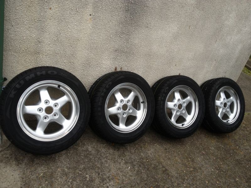

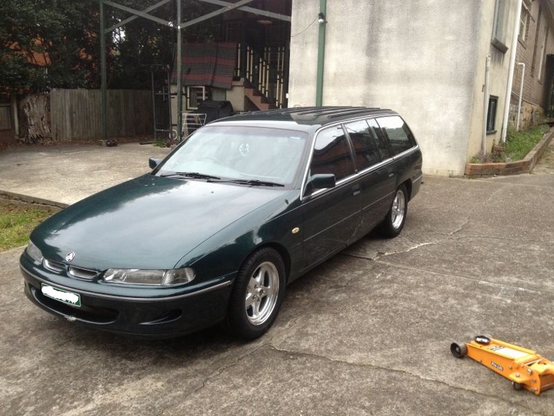

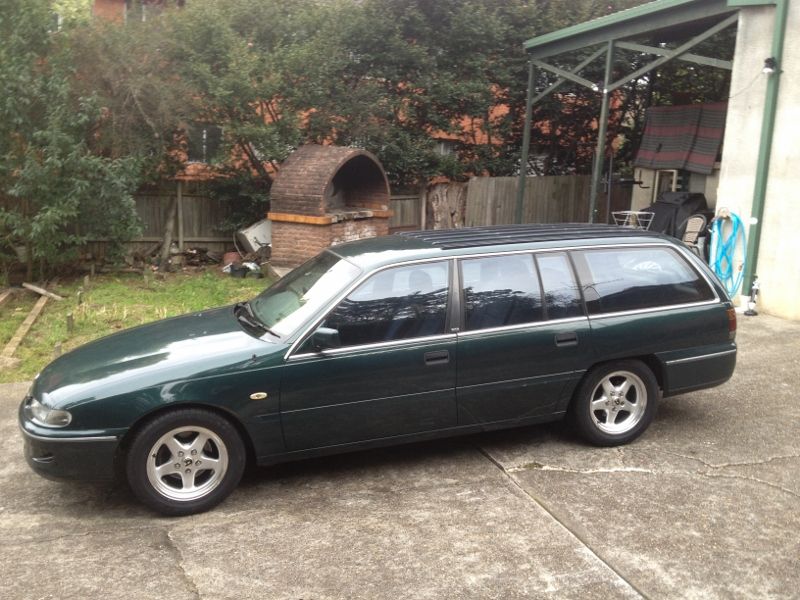

    Got these on last year, Refurbished VL walkinshaws with Kumho Ku31 rubber

    Nice man! Loving those new wheels they suit the wagon very nicely. I was also running the FTC CAI and found the intake pipe to be just a little to short
  19. VS-S
    Very nice! How well does it grip now?

    Those wheels look fantastic on the wagon. Suits it perfectly,
