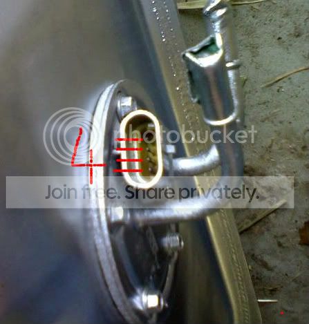

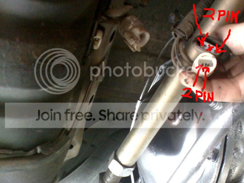

    I have bought an 80L tank, sender, straps, fuel pump, the whole lot. It's going into my VN s1 V6.
    The original 63L tank has 2 plugs on the sender unit external to the tank, a round 2pin plug and a straight 2pin plug.
    The new 80L tank has only the one plug, a 4 pin straight plug.
    Anyone able to tell me what goes where?
    Sam

    hey i want to get an 80 ltr tank for my vn as well.. how much are they and are they hard to fit? did you find out about the wireing?
  7. savage1987
    savage1987 Donating Member
    3,660
    May 8, 2005
    Wiring, not yet... need to source a plug to suit the 4 pin socket on the new tank before anything else.
    I will let you know on fitment when I get to that :)
    I'm paying 200 for this one, including pump, sender, straps, etc etc

    OK to tidy up this thread for anyone who might care, I ended up soldering the VS fuel pump plug onto the body loom side. This matched up nicely with the VS fuel pump's own plug :) Can't remember if I did the sender plug as well or if it was all the same plug.... either way it's not hard. The wires were even the same colour.
    Tank fit beautifully, is silver with black straps and definitely tidies up the rear of the car a lot. With the tank, a dual rear sway setup and the whole rear axle all painted up it's starting to look a bit tidy under there :)
