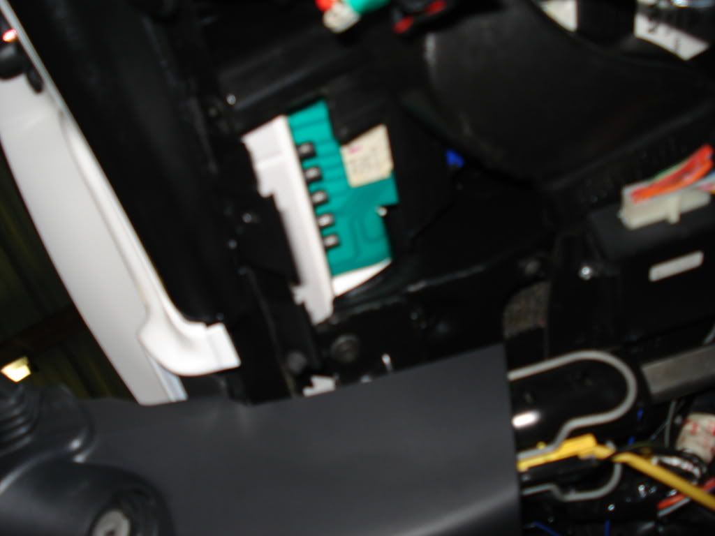

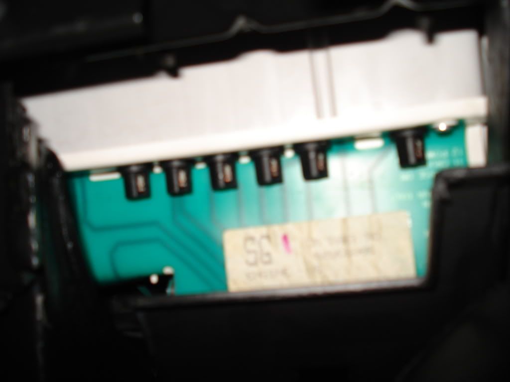

  6. r_i_d_a_h
    r_i_d_a_h New Member
    1,361
    Apr 28, 2005
    '97 VS Commodore + '98 E36
    heres a shot of under the dash.
    simply twist the black cap off and the bulb is in there,
    although, i am not to sure if you can buy a new bulb WITH the black cap
    but i usually just rip out the old bulb from the cap and slide it in and bend the legs of the new bulb.
