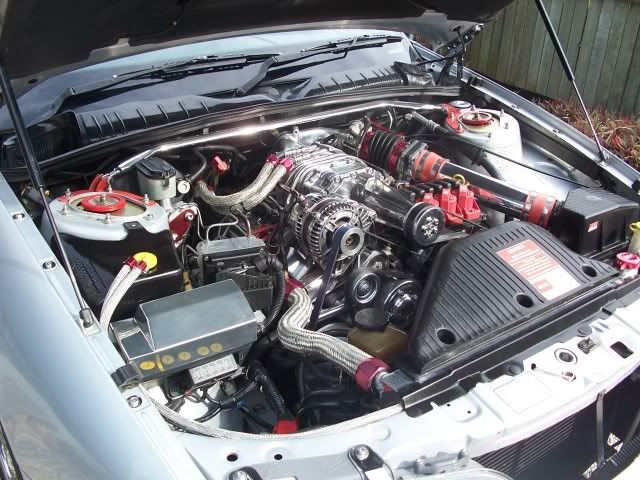

    Hey all, I picked up a CAI from Holden today, and after fitting it I found that the bonnet shuts properly? After reading threads on there I was expecting it to be a hack job (other than the air box, some holes and opening the mouth open a tad more), but the bonnet doesnt even touch it?
    Yous are on drugs. :p
    BTW, noticeable gain at lower rpm and cruising at light throttle.
    Bonnet is fully closed^

    I though my CAI couldnt get any air over the radiator on my vs statesman until the dust storm ,afterwards you could see the way the air flows by the dust over the Cai ,air box and supercharger and Im not just talking about a little bit of it also it fully blocked up my air cleaner

    Heres my arangement its standard except the 3mm aluminium piping(not rice barn or supercrap **** ) which doesnt ever seem to get hot enough so you cant touch it and also cools very quickly when you start moving also the front of the CAI has been opened up enough to be able to slide your fingers in easily ,but in general I dont often have heatsoak problems even sitting in traffic I think this is because of the heavy duty alloy radiator,cooler thermostat and the L67 has a two speed fan ( I think but not entirely sure )

    the reason yours seems to work well is because the front bar doesn't attach and block off the area right infront of the radiator panel like the VS does. hence the reason the CAI works. proves my theory really. the super 6 CAI works on VN/VP but not so well on the later VR/VS. if you look at the pic i attached earlier you can clearly see that the front bar blocks off the entire area leading to the CAI
