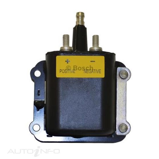

    Having trouble trying to determine the correct ignition coil part number for my S1 VT Calais with the 5 litre (304). My understanding is that they went to a difference ignition coil in the VT model compared to earlier models which rules out the Bosch MEC718. Any possible guidance would be appreciated.

    Bosch MEC718 is the correct ignition coil for your VT V8 S1.

    Called Burson yesterday, girl over the phone said I needed a PAT IGC-009, which is a Bosch MEC726. Now very confused...

    As you can see one is a plug in the other has to be nutted down.. The plug in one is what Bursons told you.

    Looks like I gave you some bad advice. My apologies for the confusion. My memory must have been better in 2004 !!!
    The main difference between the two is that MEC718 uses screw connectors, whereas MEC726 uses a 2-pin Jetronic connector. The VT should have the 2-pin connector so you will need the MEC726. Using a small mirror, you should be able to easily confirm the type of connector used.
