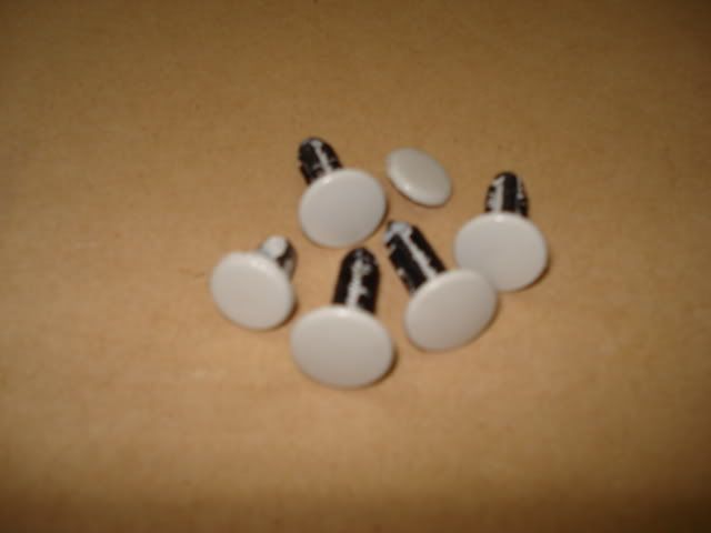

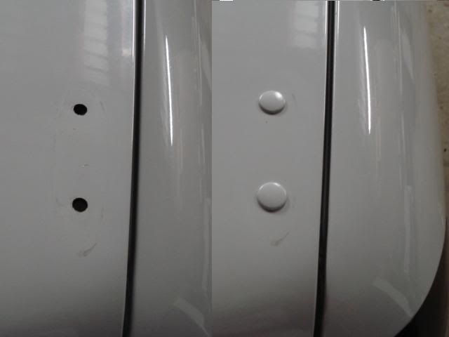

    hey guys wanna remove my spoiler wanted to no are the holes really big?? can i get any thing to fill the holes or is it a better to get a new boot??? thanks

    Nah the holes are not really BIG but I know you can get plastic plugs to cover the holes.
    Otherwise you could get the holes welded and painted.
    Though probably be cheaper if you got a 2nd hand boot, and got it re-painted and fit it yourself.

    I have never seen the holes that a VX SS spoiler leaves when they are removed but I have seen the holes a VS spoiler leaves and I found some pictures for you :) Once the spoiler has been removed you have two options, plug the holes using plugs or get the holes in you boot welded up (or get a boot from the wreckers with no holes)
    These are the plugs that you can use to fill the holes:

    And this picture shows the size of the holes and what they look like when they are plugged (Remember the holes are for a VS Spoiler but I doubt they will be too different)
