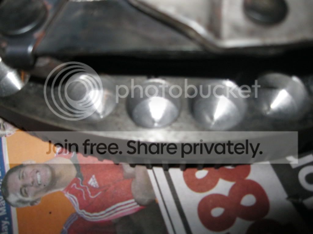

    You see what happened was I read on this forum that the fly wheel should be neutral balenced, so me always trying the cheap option first had my uncle machine the counter weight off. the damn car shook its tits off. $180 later and one wasted night.
    because of this
    At least my fly wheel is damn light!
