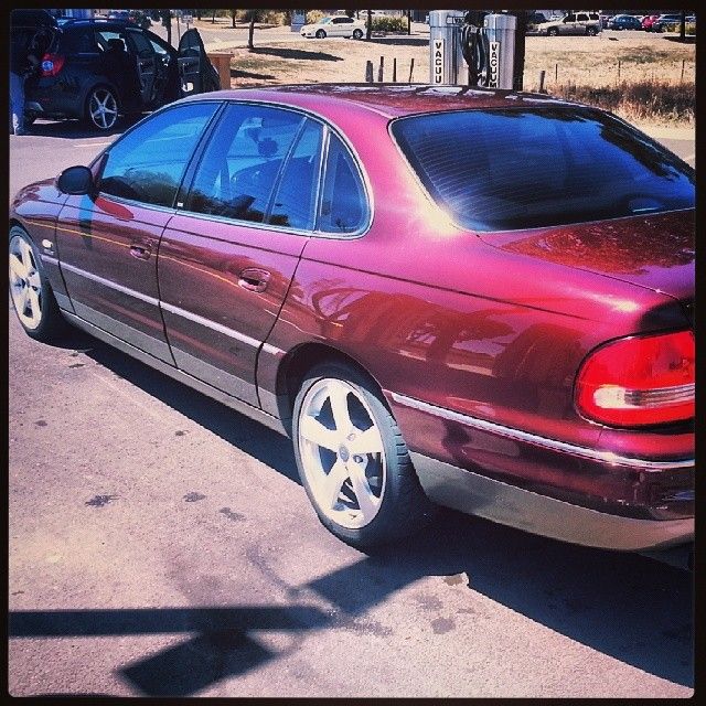

    May 14, 2011
    2002 VX SS
    like the wheels m8. Auto carwash...eeekkk... never, ever use one .those spinning brushes will give you masses of swirl marks on your paint that can only be corrected properly with a da polisher and cutting compound. look at ur duco in the sun, if you can see spider web swirly marks thats due to poor washing and drying methods, hopefully u dont have any, (yet..). had them on mine caused by previous owner , so used the da polisher and they are gone. other than that your car looks sweet...cheers
