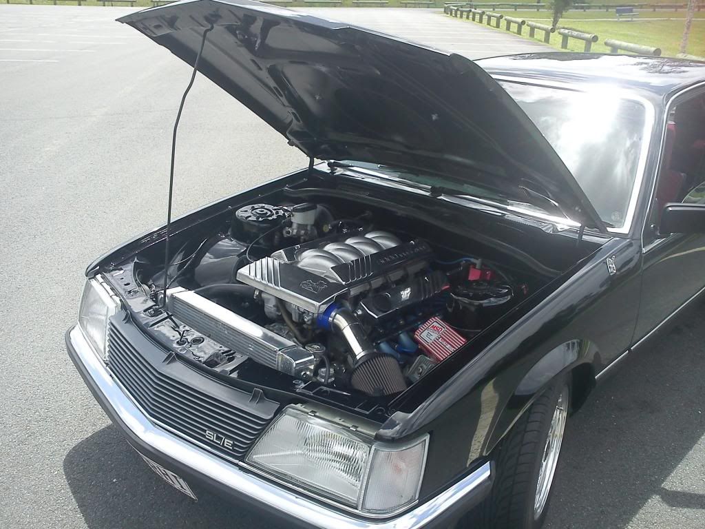

Ok, so it started out with old tired but grumpy solid cammed 308 and leaking oil everywhere.
I gained knowledge from the likes of Darren and his SS and a few others on here and was convinced to drop in a 5L engine.
I sourced all components required for the conversion.
This is how it turned out!
There isn't any progress pics as my laptop was stolen along with all the pics.
So here is what I had stored on my phone

Wicked looking car dude! Now I've seen how shiny your rocker covers are, am defiantly going to sand mine back again for another polish! Looks tuff

cheers mate...im pretty happy with covers...i just hit em with paint stripper, then the air sander on 400grit then 1000p wet an dry then 6hrs worth of polishing on the bench grinder with a soft stitch wheel.

Nice man got any more pics of the outside?
thanks...nah not as yet... i need some tho! as soon as i roll it outa the garage i will!
